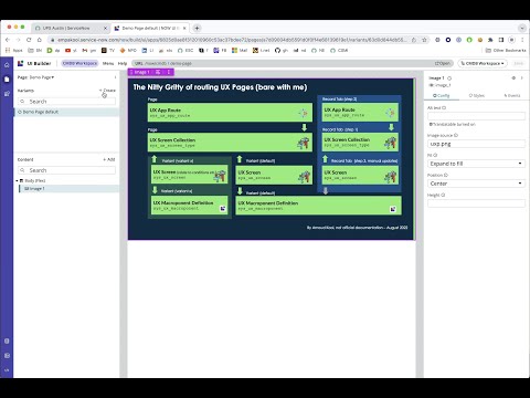

Video 2. This video covers how to add Playbook as a Record Page Tab to a Configurable Workspace using UI Builder. The community article can be found at: https://www.servicenow.com/community/next-experience-articles/adding-a-playbook-record-page-tab-to-a-workspace-record/ta-p/2331950 00:00 - ...
Video 1. Background variants vs. screens with a simple example This video tries to explain the metadata involved to create a UI Builder page. There will be a part two and a community article in the next couple of days. 00:00 - Intro and goal 00:36 - Metadata records of a UI Builder page 01:32 - ...
