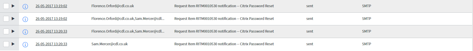

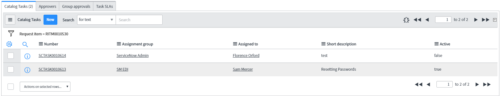

Hi Sakshi,
Thanks for all the detail above.   Still trying to get to grips with the scripting, never done any before until started with ServiceNow, and still new to SN.     I've checked and there was issue with data for one of the managers   The script now correctly send notification to assignment group managers if assigned to is blank.
I had 1 RITM with 2 tasks on it.   On both task assigned to was populated.   This correctly sent a notification to both users, however 1 user got a second notification also sent, any idea why they would get 2?
I also tried where one task was closed.   It sent the notification to the assigned to of the open task, but then a second notification sent and this went to both users (the one of the open task and to the one of the closed task, any suggestion as to why this would happen.   Below is a screenshot of the Email logs:
The one sent at 13:19 is where both tasks were active.   As you can see it sent the notification first to Florence.Orford and then sent another one to both Florence.Orford and to Sam.Mercer.
The one sent at 13:20.   This is where one task was closed (assigned to Florence.Orford).   Again can see it sent to both first, and then just to sam.Mercer for the second.
Let me know if you need any further information.
