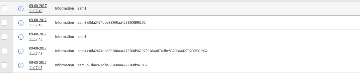

I've just tweaked the logs and the email_to.push statement.
Please run all the 4 use cases and share the logs/results:
1. both tasks have assigned to
2. both tasks don't have assigned to
3. task 1 has assigned to & task 2 doesn't
4. task 2 has assigned to & task 1 doesn't

Hi Sakshi,
Thanks for the above.   Hope your exam has gone ok.
I've ran the tests and evidence below.   From what I can tell this seems to now be working ok.
First Test - Both Tasks are unassigned:
Both Group Managers Get the Notification:
Second Test - 1 Task is assigned, the 2nd is still unassigned:
The person assigned gets the notification and the manager of the group of the unassigned task also gets the notification:
Third Test - Task 1 is unassigned, the 2nd task is assigned:
Both the person assigned get the notification and the manager of the group of the unassigned task get the notification (now working):
Fourth Test - Both tasks are assigned to people:
Both getting the notification:
Fifth Test - Both Tasks are assigned to people (reverse - to show both people can receive the notification):
Both Still getting the notification:
I'm going to run some more tests, but looking good.
Thanks for all your help on this - appreciate all your time over the last couple of months
Thanks Sam
