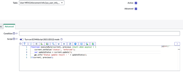

@Ambuj Tripathi : Thank you so much for your detailed reply and your response really helped. It is enforcing the MFA now if we change the status to enforced.
Could you please help me with the BR, I have tried with both before or after BR, with insert and update but it is not setting the status from tracking to enforce, after user is logged in with local cred, I have to manually set the status to enforce once the entry is there in table, then at the second time it is asking user to setup MFA..
Hi @Dinesh90
As I mentioned, the existing users who have an entry here already, will not be getting updated. The BR will only be applicable for the new users.
Please make sure to add the additional checks whereever applicable.
