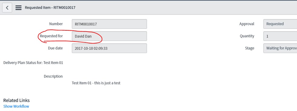

Ok, so I understand where you were coming from now, but that's not directly what I was inquiring about. Let me show you different screenshots from my dev sandbox. I was able to replicate this scenario in my Dev sandbox. For the "Requested Item" module link under the Self Service application (which points to sc_req_item). If we add the Requested For and Opened By columns to the list layout, under the ESS view (&sysparm_view=ess), the column does not populate the Requested For, when it's not the SS user logged in. But when you click into the record, you can see the user name on the Requested For.
if you remove the (&sysparm_view=ess) from the module link for Requested Items, it shows the name in the list view. So my question is, do you know how or if ACL/security is tied in specifically with the ESS view? No ACL's were updated for this in my dev sandbox.
