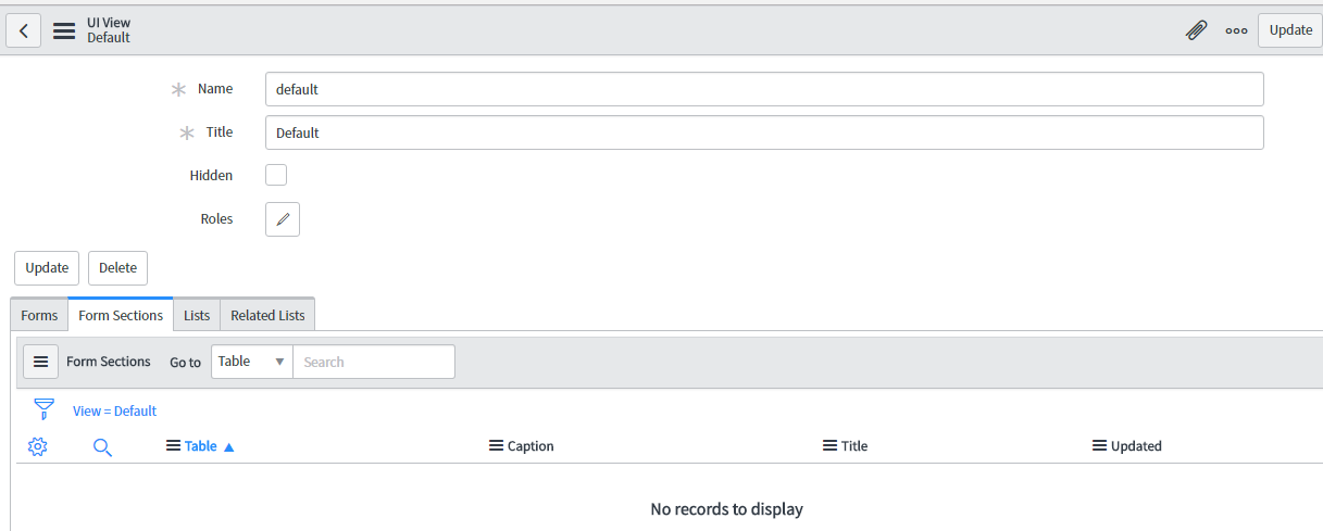

I am facing issue with creation of Duplicate "Default" view in our instance.
Recently we are facing issue with duplicate view "Default"   on demand table. When ever we create a new record or open a demand from list layout, The form is opening in "Default" (Name is "default") view. But it should open with OOB Default view (which has empty name).
Even I have deleted the entries under "System UI > Views", I can see Demand forms are opening with "default" view. I observed new "Default" view created when ever I opened the Demand form.

This is screenshot of duplicate default view form which doesn't have any records for related list.

We have one incorrect view rule, that was causing the issue. We have fixed the issue by changing the view rule.
I observed if view created for Form design then logical name of view will be empty and emtpy view will show as default one. And views rules on page will cause issue.
If you created new view on table, then check the logical name of view. There should be one view without logical name.
