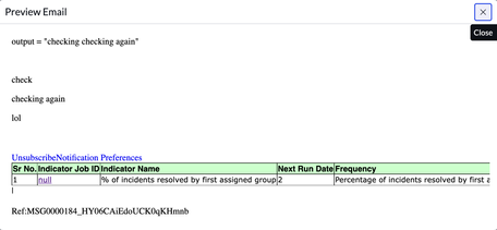

Im just testing notifications that are getting triggered from a scheduled job
this is how the notification looks like and the email below

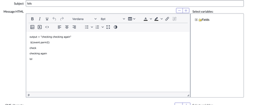

Im passing a table to event.parm2 through schedule job and event queue also pls ignore the headings
Any idea as to why its acting like this?
Sandeep Rajput
@niveditav Try accessing the event.param2 via a mail script instead of directly accessing it in the notification body.
Hi Thanks for the suggestion but the problem was that i forgot to add </table> at the end which servicenow had no issue rendering but outlook did
