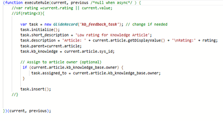

Hi Experts,
When a published Knowledge Article receives a rating of 1 or 2, a feedback task should be created.
I have implemented a Business Rule, and the feedback task is getting created successfully.
However, the created feedback task is not appearing under the Feedback Task related list in the Knowledge Article form.
BR:
Could you please check and help resolve this issue?
Thanks.
