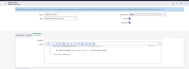

11-06-2023 02:18 AM
@swapnil15 You are writing business rule on "sc_req_item" table and you are doing glide record query to same table. Its not required at all. If you want to verify time worked value for RITM then simple add gs.addInformessage() as below and try updating the RITM record then you will that message.
can you see Time worked field on the RITM form ? check my below post
