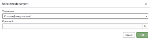

I have a record with a Document ID on my Goal Framework.
First you have to select the "Assigned entity type" e.g. "company".
Then you can look up the company via the "assigned entity" field, which is the type Document ID.
Once the modal opens i want to filter the company List.
I cannot use the reference Qulifier since the type is a Document ID.
In my example i just want to filter the companies, but not any of the other possible Tables.

Thanks for the quick answer.
I found the link previous to asking this question, but as far as i understand the answer, its only limiting the number of tables displayed on the "Table Name" field.
I however want to filter the "document list", when i already selected a specific table.

03-19-2025 05:41 AM
Bit of a thread zombie here, but I'm VERY curious how you were able to get your tablename field to show both labels and values like this....
Mine ONLY shows labels.
