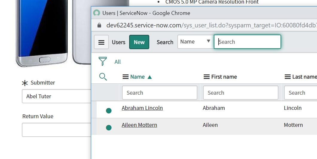

Here is the screenshot, use this as reference.
Script Include:
Variable where filtered result is required, for your case it is approver
Here is the output:

Try using script include, where you can return 'sys_idIN'+submitter.manager.sys_id+','+submitter.manager.manager.sys_id; call that script include in advance reference qualifier of your approver variable.

That worked.  Thank you very much!
OK, that did work, but I just came across something I didn't consider.  I am defaulting the Submitter to the current user, and it shows the managers for the current user in the Approver box.  However, if I change the Submitter to someone else, those filters do not seem affected, so it still shows the Approvers for the original person in the Submitter field, not the new one.
How can I get that to update?  I am thinking something like Catalog Client Script, but are not sure how we would affect the filters on the variable from it (I have a feeling I may be overthinking this and overlooking something obvious here).
Pass current.variables.submitter in your script include function as a parameter. It will make your filter dynamic.
