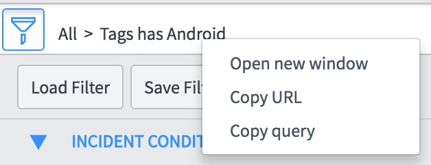

First, I went to the list and built the filter I wanted. Example: incidents tagged with Android, look like this:
Then, I right click on the breadcrumbs of the filter to get the query.

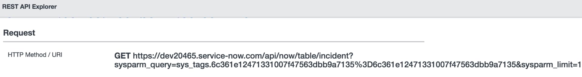

Then I pasted that in to the sysparm_query field in the REST API Explorer to test...
Then I checked the URL after hitting Send and it shows me what I need to build for the API.
