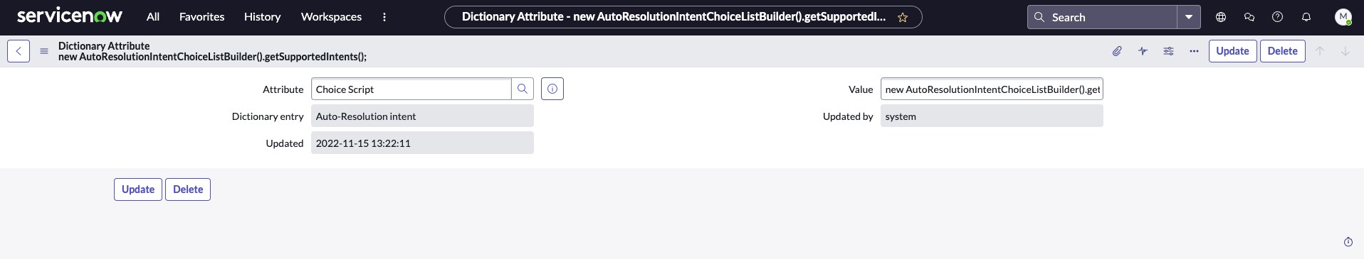

Hello, I have a fix script that is intended to change a dictionary attribute (from sys_schema_attribute_m2m table) value after upgrade. When testing out the script using the "Run fix script" option it works as intended, and when testing it out on TD upgrade scenarios it is correctly updating the value based on log values for gr.update() (see 'Log messages' photo). However, for some reason the value gets overriden by the system restoring it to its original value around 15 minutes after the upgrade is finished (see 'Dictionary attribute' photo). Record for rollback has been set to false. I have looked at upgrade and localhost logs and cannot seem to find anything unusual there. Does anyone have any ideas what the issue might be?
