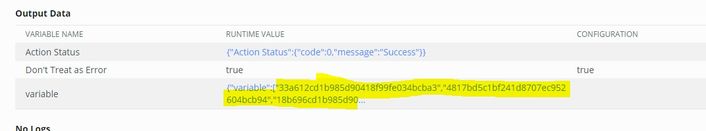

We have a catalog item with List Collector variables and Based on the List collector variable selection we need to create the SCTASK tickets.
And so far everything is working fine but during the flow action output level we're seeing the list collector selected options sys_id's
But we want display the selected options names.
Below flow action we created and called on flow level and both input and output types are array.string.
We gave a try changing the type array, object and array.object but no luck.

08-03-2023 08:38 PM
why not query that table with the sysIds and store the display value in array and then return it

08-04-2023 05:19 AM
then to make it re-usable ensure you pass these 2 inputs to that action
1) table name being referred by list collector
2) sysIds
