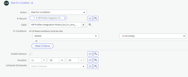

I created a flow with a "Wait for condition" action. As a condition, if my “Details” field receives some value, the flow continues its process.
Now the problem is that my flow has a huge delay when the condition is met. For example, if I set a value in my "Details" field, the flow will only continue/update after 6/7 hours...
Could someone please tell me why the flow has this behavior?

What happens if you remove your timeout and duration from the action? Is it picked up instantly when setting details then?
Mark
Hello @Mark Manders
I removed the timeout and the behavior is the same

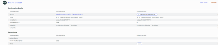

It only took one second, so that's good, right?
Mark
No, if you examine the second print, you will observe that the state of the flow remains in the waiting state (top right corner), even after the condition has been met.
