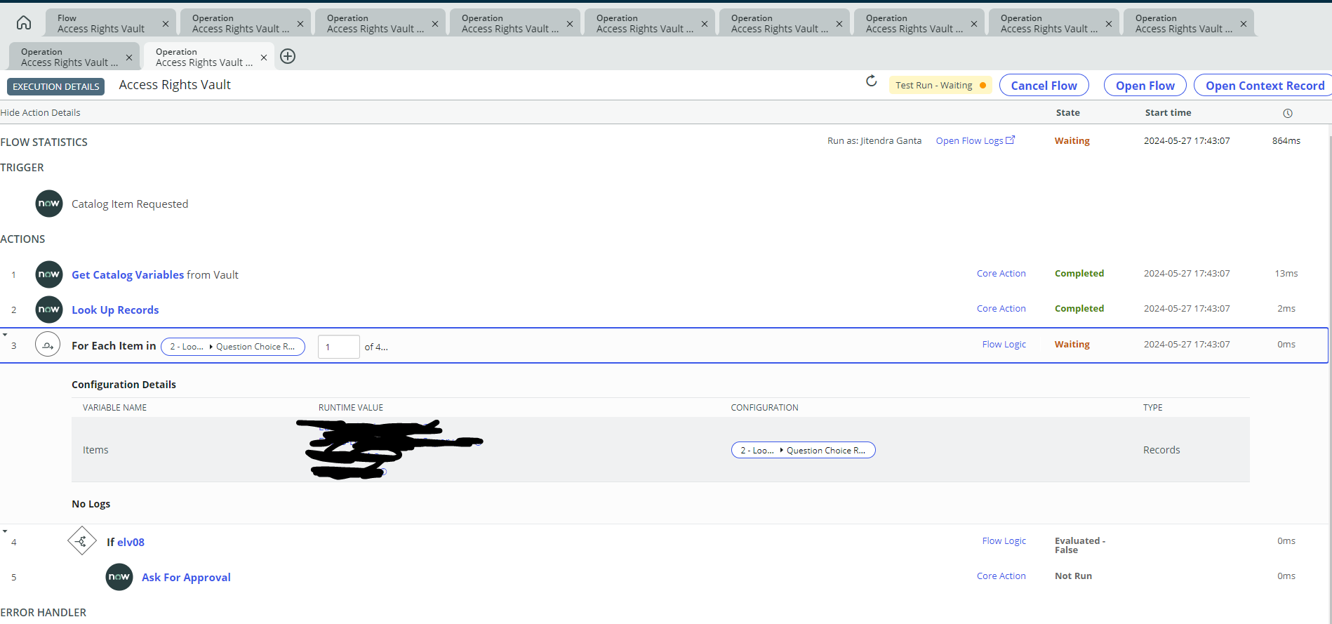

Hi @Josh Pirozzi ,
I am kind of stuck with this solution. Can you please help me my flow is getting stuck in for each loop and shows waiting. The approval is sending as well but shows it was evaluated as false.
Please find the attached screen shot.
