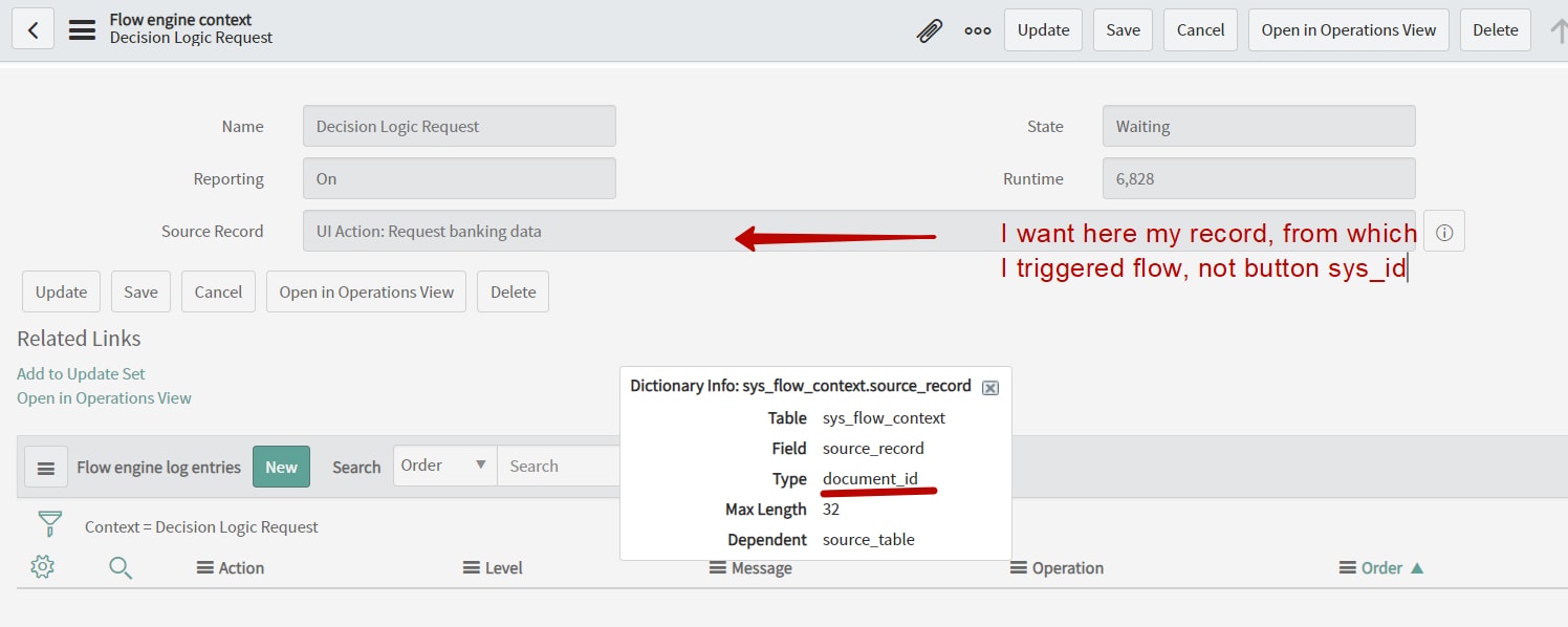

BUT! I can't properly query it, because source_record(document id type) field, is populated not by my record (like in triggering by condition), but with sys_id of my UI action, so I can't find in sys_flow_context my context by sys_id of my record.
This is how reference looks like:
Is there a way how I can set this source_record field manually from snippet, or maybe can I query my flow context through some other tables?

1 record (Claim) in my case could have multiple flow executions (4-5), if I will use
var contextId = sn_fd.FlowAPI.startFlow('decision_logic_request', inputs);
I would have to store all this contexId's in some comma-separated field, before cancel all of them at once (when I will need it), like workaround it's fine, but still would have ability to query all of them through sys_flow_context by sys_id of my Claim (record, where flows was triggered of)
