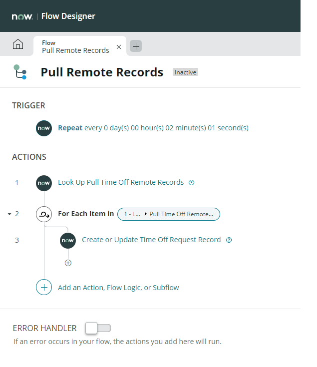

Above sounds like a job for Flow Designer so I made a test:
1. Find records with some criteria
2. Loop through all of them
3. Create a record for each
Problem:
The above creates only one record even though in step 2 (for each item) the system finds multiple records.
How to create multiple records then?

I think you've added your step in the wrong place. If you click the tiny '+' icon under the 'for' loop and create the same activity does it work? If you've done it correctly you should have an action at order 2.1 instead of 3.

10-31-2018 11:45 AM
Thanks Mark! This was the issue, now I get multiple records.
