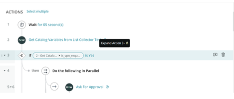

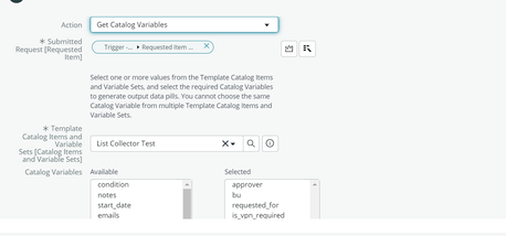

Hi @servicenow_devo ,
You can use the Get Catalog Variables action to get the variables and after that use the If and else flow logic based on your requirement.
Refer Below
If it helps please click Accept as Solution/hit the Thumb Icon.
