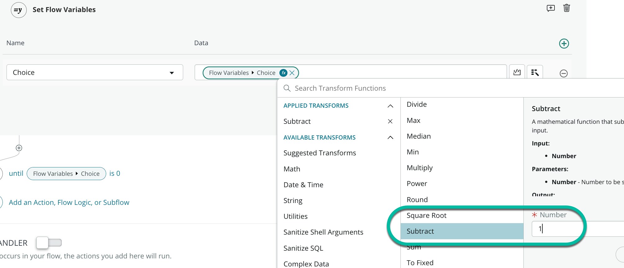

You could use the Do the following until flow logic. One solution would be to save the value from the choice list as a flow variable, and then decrement the value every time you create a record/case. This would mimic the standard for or while loops in Javascript:
The above flow sets a value for the flow variable (I called it Choice in mine). Within the Do the following block I i) create a record and ii) decrement the Choice variable by 1 using a transform function:
The block repeats until the value of my Choice variable is 0.

Thanks this worked like a charm!

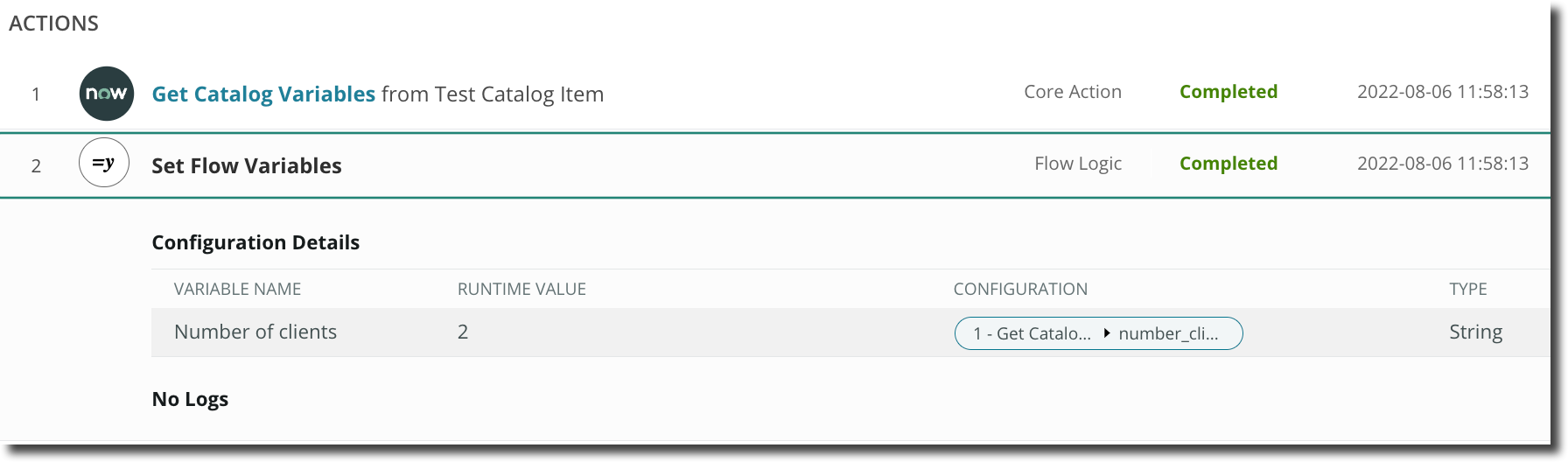

Hi Jason Nichols,
On the first set flow variable what is the value that you are setting? I also have this similar use case.
In a record producer there is variable number_of_client_ids (choice field), based on this choice looping should done (If the user selects 3 in that choice means looping should be done thrice).
But the problem here is If I am creating a flow variable I have to pass this choice dynamically, but the data pill in flow variable is not accepting the data type choice
08-05-2022 07:03 PM
Hi Krithika,
I was able to set the flow variable from the catalog variable.
In my catalog item, the variable was a Select Box type. In my Set Flow Variables step, I am able to use the catalog variable data pill:
When ordering the item, the flow variable value is set to the value from the catalog variable (in the example below, 2😞
