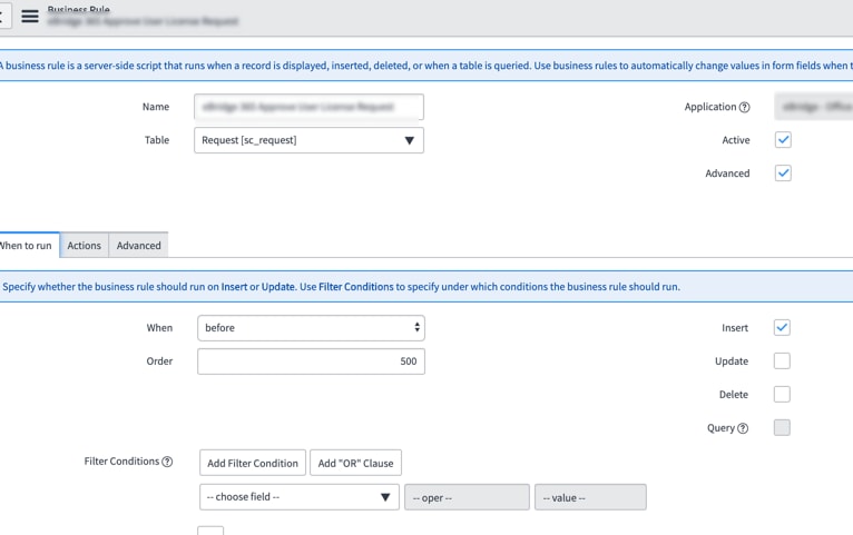

Here is the final solution that resolves this. I needed to add a business rule that triggers on insert of sc_request. However, the solution cannot simply execute for all sc_request insertions. Rather, I only wanted it to trigger for my specific sc_request. Therefore, my business rule setup is listed below. Notice that I'm specifically looking for attached sc_req_item records that have the exact number of variables as well as the exact named variables I'm looking for. If it matches, then the script will update the sc_request.approve to approved. Hopefully this helps others if they are struggling.
