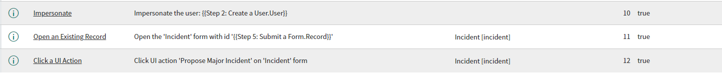

Hello there, I am running ATF with a step to 'Click UI Action' - however I keep receiving this failed result:
'FAILURE: Failed to find UI action 'Propose Major Incident' on 'incident' form'
Does anyone know where I can look and try fix this issue please? These are my last couple of steps if that helps? Thank you

Did you check this
1) In Step 11 screenshot are you able to view that UI Action
2) Possibly the UI Action condition is not satisfied for your record and it is not present on the form i.e. not visible
Hence ATF is unable to detect that UI Action

Thank you for your reply Ankur. I wasn't able to see the UI action, but that lead to another way to populate the button so it is viewable. ATF is now working. Cheers, Winnie.
