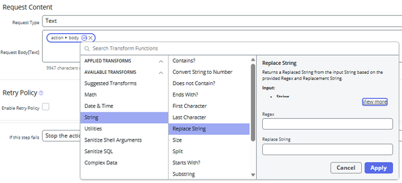

There are a few control characters that need to be escaped for valid json. You can use the glidestringutil api. Or just use the json builder step in your action
GlideStringUtil.escapeNonPrintable("a\n\t\b\''''")You can also use the transform functions on data pills

click on "Add new step" look for "JSON Builder" and then click on "Add JSON for payload" enter your payload and click "Generate JSON payload" just drag and drop you action input under "summary" the payload is ready.
Now in "REST Step" under "Request body" use "Data Pill" to add your payload.
