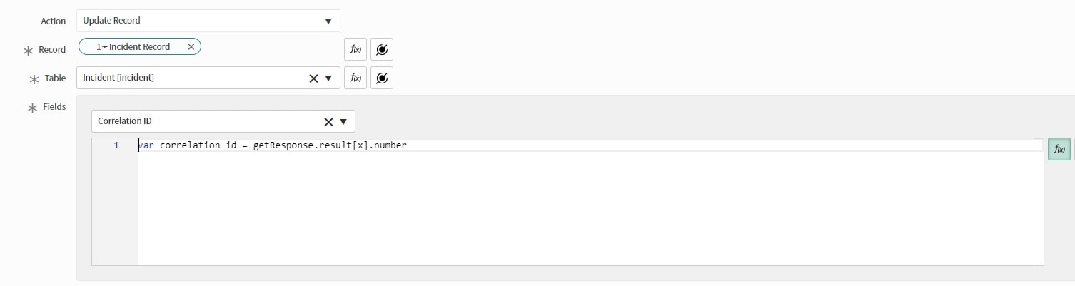

I have a question regarding the use of scripts in Flow Designer. I have a script that creates and updates an incoming email into a incident ticket. The last part of the flow I have added an update action for the incident with correlation ID so that when a supplier sends their correlation id in the email subject line this populates the correlation id field in servicenow ticket and I need to write a one line script using the f(x) box.
So far I am able to pull the entire subject line into the correlation box, but I only need the number,
Appreciated your assistance
Many thanks
Steve

Dirk,
Thank you for the response, its the script I seem to have a problem with in getting this to work.
Kind regards
Steve
Hi
Did you make sure, that your script must RETURN a value?
You need to:
var correlation_id = '23456789'; // Or whatever you will calculate
return correlation_id;
If you do not return your variable, it will not work.
Give that a show
Let me know if that answers your question and mark my answer as correct and helpful.
BR
Dirk
