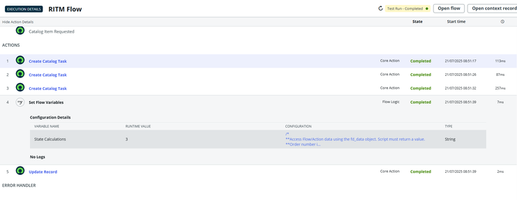

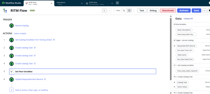

AniketC85155510
Hello @Pratiksha KC ,
Yes, this requirement is definitely achievable using Flow Designer only—everything can be handled within a single flow.
I had a bit of free time today, so just quickly tried and tested the logic in my personal developer instance (PDI), and it’s working exactly as expected 🙂
Let me walk you through the approach step-by-step so you can set this up on your side:
  1. Step 1: Add a "Get Flow Variables" Step
    Start by adding a "Get Flow Variables" action in your flow to retrieve the value of your catalog variable:
    Variable name: how_many_tasks_required
    The output from this is used in the script to determine how many tasks to expect.
  2. Flow Variable Logic
    First, I created a flow logic variable which does all the work in script and acts as a decision-maker for what the RITM’s state should be based on the states of its generated catalog tasks.
  3. Placed Flow Variable Calculation After Task Creation
    This flow variable step is placed after all your catalog tasks are created (so that their states can be correctly evaluated), and before you update the RITM’s state.
  4. Script Used in the Flow Variable Step

and then you can simple use this flow variables output to set or update the RITM's state.
adding few screenshots just for your understanding.
FYI- I did not added the dynamic catalog task function since you were not facing any blockers there.
  • Place both the Script Logic and Update Record steps after your Catalog Task creation.
  • This way you can keep all processing within Flow Designer.
  • The script as written covers the three main conditions:
    • If any task is Closed Incomplete, the RITM is set to Closed Incomplete.
    • If at least one task is Closed Complete and the rest are Closed Skipped, the RITM is set to Closed Complete.
    • If all tasks are Closed Skipped, the RITM is set to Closed Skipped.
  • You can test this flow by setting up various task state combinations and confirming the RITM moves to the correct state.
