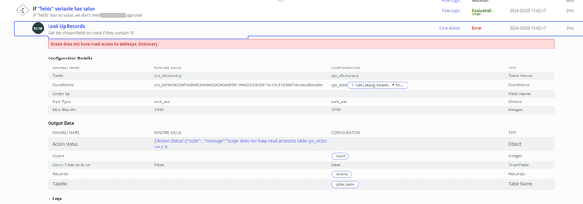

Hi Developers,
I need your help with a peculiar error that I can't quite figure out.
I am creating a flow and using a "Look up records" action to find "sys_dictionary" records fulfilling some specific filter conditions. The flow is running as System User.
I am getting a "Scope does not have read access to table sys_dictionary" error.

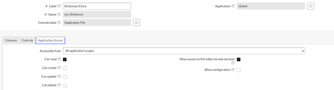

Both the flow and the sys_dictionary table are in the global scope. The sys_dictionary table is supposed to be readable from all scopes.
Do you have any idea why this could be happening and how to solve it?

The error you're encountering, "Scope does not have read access to table sys_dictionary," occurs because there are certain 'Core Tables' in ServiceNow that cannot be accessed directly using the Flow Designer lookups. The core tables that have this restriction include:
- sys_dictionary
- sys_db_object
- sys_db_view
- sys_db_view_table
- sys_db_view_table_field
- sys_documentation
These tables are considered integral to the platform's functioning and have restricted access to ensure system integrity and security. Consider using scripted steps, Script Includes, or Business Rules to provide a secure workaround for accessing these tables.

03-03-2026 03:02 AM
I had the similar issue. I marked "Don't Treat as Error" as true inside "Look Up Record" action of flow and it worked.
Try and let me know. Mark as Helpful if this resolves the issue.
