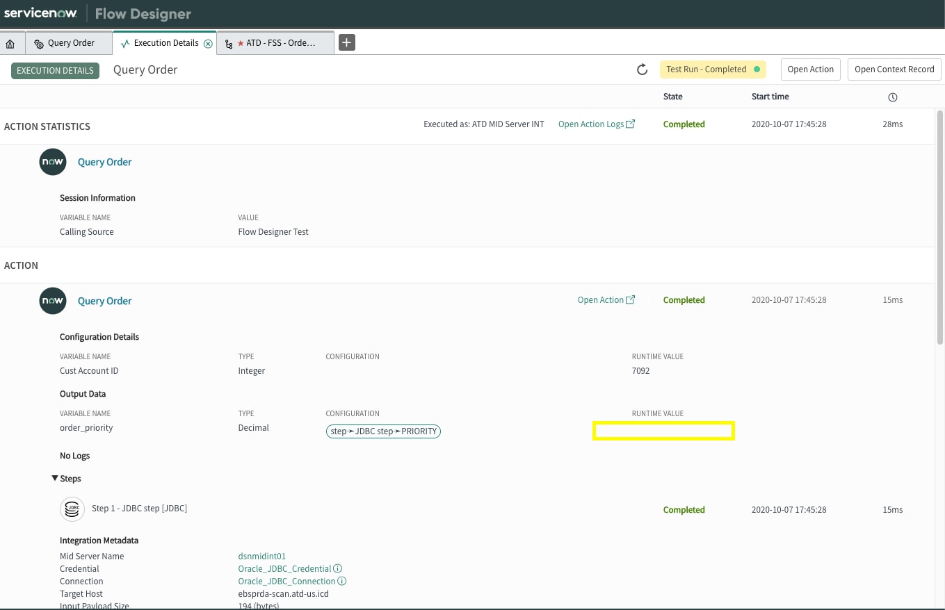

We have a requirement to set the priority of a request equal to the highest priority open order in our Oracle database. Using Flow Designer we've created a JDBC step and successfully tested a connection and query. The query returns an integer between 1 - 5.

We are struggling, however, to use the value to set the priority of the requested item. When we create Action Output variables we are not able to set it equal to the result set value and use later in flow.

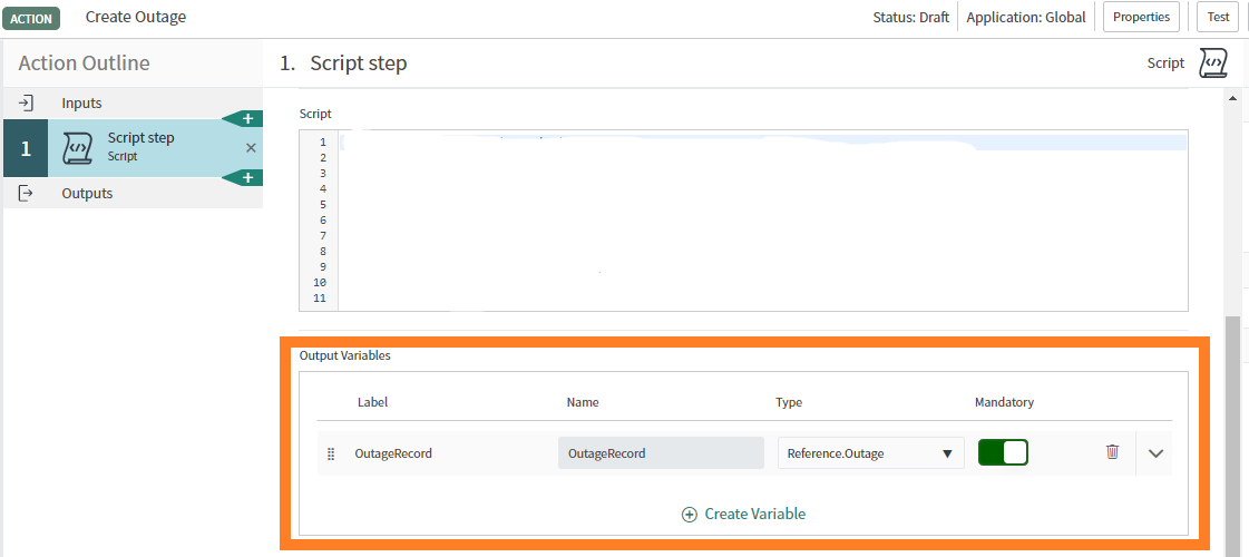

1st image seems to be your script in action, right?
Step1: In that case create and output variable in script section like this
Step 2:
Create an output variable type reference and respective table.
Once you have done both publish it and try to add this is flow and you will get whole record and you can use it as per requirement.

Thanks, Rohit,
We're actually using a JDBC step to get a value from an Oracle database, which doesn't have the Output Variables section you highlighted. It creates a complex object and which we are trying to parse into an Action Output variable.
I've added additional screenshots to the question to clarify; thanks!

Hi @Victor Sirianni I have the same requirement, but in the output I still have the empty value. Did you do the script in your output variable?
