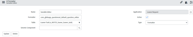

‎12-13-2022 02:55 PM
Would you be able to share a screenshot of the formatter you created for the task table?
‎12-13-2022 03:01 PM
Sure!
