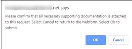

Our team has onSubmit client scripts that bring up a confirm pop-up dialog box:
var action = g_form.getActionName();
if(action == 'submit_revision') {
  var submit_answer = confirm('Please confirm that all supporting documentation is attached to this request.  Select Cancel to return to the form.  Select OK to submit.');
  if(!submit_answer) {
    return false;
Right now, that pop-up box shows our instance name and then the confirmation message:
Is there any flexibility in taking the instance name out and replacing with an actual title?  Thanks!

Im afraid that will not be possible, only alternate would be if you make a ui page and use that as a popup here. but id suggest to stick with this as this is the simplest solution and doesn't require any custom objects to be created.
It is actually a security/anti phishing feature why this is locked.
-Anurag
-Anurag
hm interesting...thanks @Anurag Tripathi !  Is there an option to hide the instance name or does that have to be there?
I dont think there is any possibility to manipulate this.
IF it is so important then id suggest you create a custom ui page and show it. On the ui page (being used as a popup) you can control the title.
