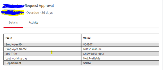

Business is using one standard format of table for showing all the necessary details as below while showing Task/Request on portal :
This table is filled in rich_description field to map to details in portal side. But as you can see the styling for table rows is not fixed and the number of rows populated in table is based on HR services.
So we decided to develop a custom flow action where we can simply pass the field and Value pairs using flow Data pickers and inside custom action will handle rest of the things i.e. Constructing HTML and adding styles for table. for that purpose we need functions to construct each row.
I hope now its clear to you why we need to use functions inside flow designer with dynamic outputs.
