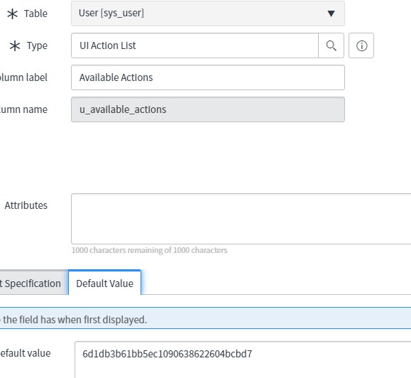

@Ankur Bawiskar Hi Ankur. This is the field UI Action List, the default value is the sys_id of the UI Action in my code.
On the list view, it appears as this:
I am in Quebec release and unable to create field type UI Action list
Hi Anwar. This is a field not available to users and can be requested by ServiceNow. However there is a workaround to create it. Please see below: Alternatively, there is a current workaround if you don't want to mess up with the ACLs which maybe a better approach. Please follow the following step: 1. Navigate to sys_dictionary.list 2. Under the 'Type' column, filter it using 'UI Action List' 3. Now, right click on any record in the 'UI Action List' column then click 'Show Matching' 4. Click the new button and you should be able to see the Type prepopulated as 'UI Action List' You can also click on this link which already do the 'Show Matching' for you —> https://[instanceName].service-now.com/nav_to.do?uri=%2Fsys_dictionary_list.do%3Fsysparm_query%3Dinternal_type.labelSTARTSWITHUI%20Action%5Einternal_type%3Dglide_action_list%26sysparm_first_row%3D1%26sysparm_view%3D
