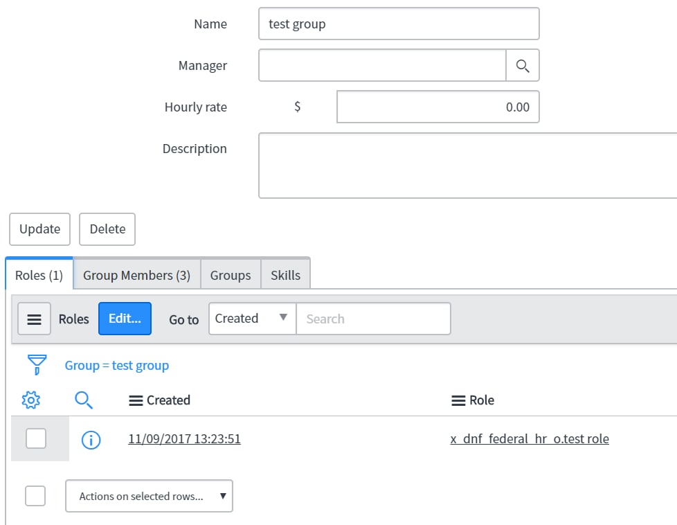

Hi Everyone, our team is creating a widget in a scoped application and am running into some ACL issues.   In the back end, we've created a test group that contains a test role and included three users.   The test role does not contain any other roles.
