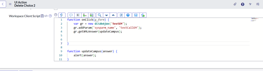

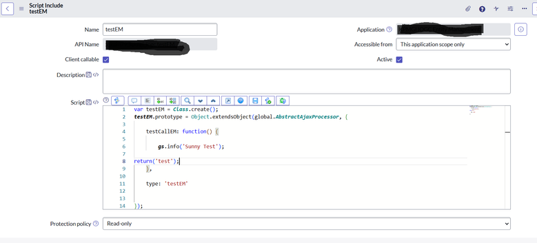

I am trying to configure a UI action that will run on the workspace view of a record. I understand that to execute the code in the workspace, we need to use the workspace client script. Therefore, I have written the following code to call a client-configured script include. Details are provided below:
Script include:

I have created a basic script to test the script include call, but I'm not sure why the script include is not being invoked from the workspace client script within the UI action. Am I missing something?
The same script include can be invoked from On chnage client script. This works correctly.
Note: Script include and UI action both are in the same application scope.

script include and UI action both are in same scope?
Simply add alert at line2 before GlideAjax to check if alert comes? If alert doesn't come use console.log() and see if it came in browser console.
remove line 8 and check if log came?

We ran into the same issue. I assume you’re working within an application scope, since you masked it in your example. In a Workspace Client Script, you need to call the API name of the Script Include for it to work correctly.
In your case, it would look like this:
var gr = new GlideAjax("<insert_scope>.testEM");
