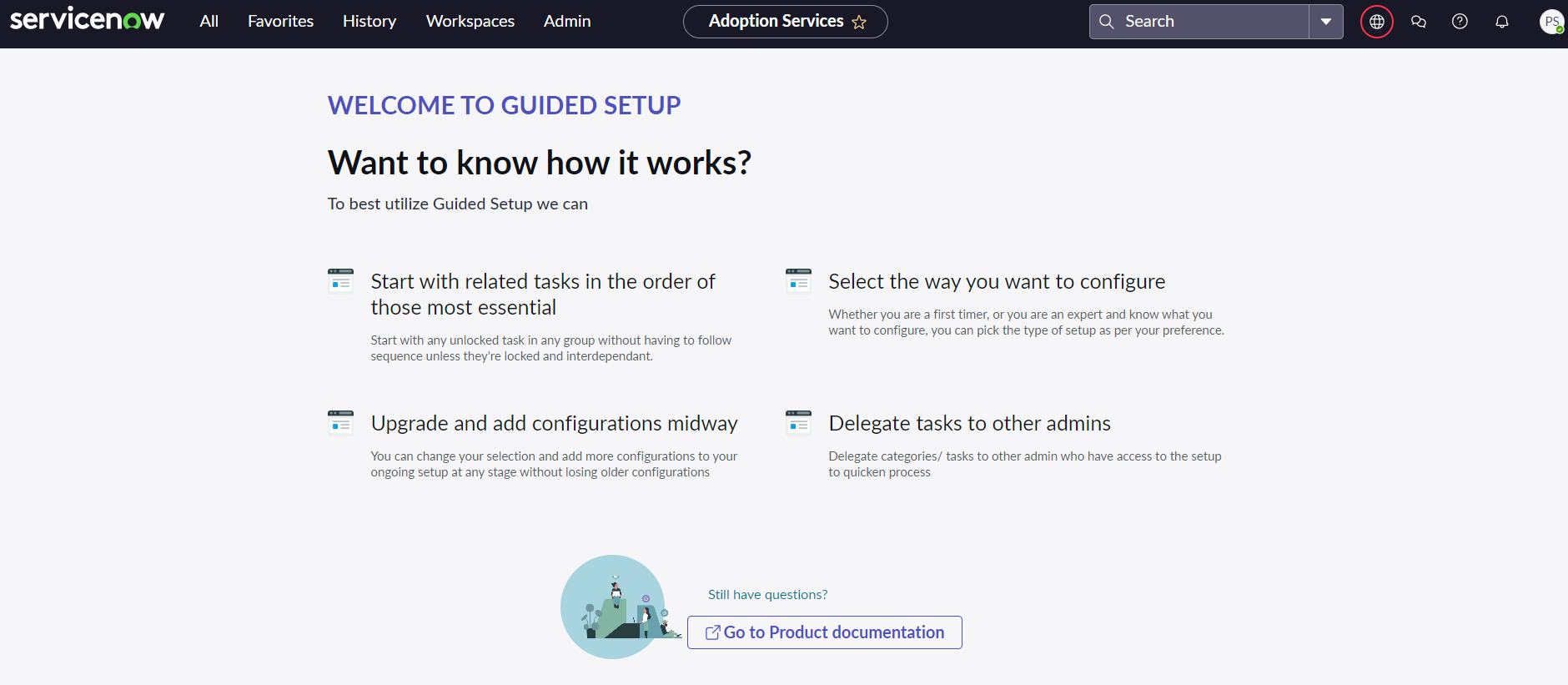

I have created a scoped application and need to add a guided setup to it. Following the documentation provided here, I created a guided setup using the adoption service. In my application menu module, I am using the following URL as the direct link: /now/adoptionservices/setup/{guided setup sys_id}.
However, when I publish my scoped application to the application repository and install it on a different instance, the guided setup module opens with all steps marked as completed, although users can still configure the guided setup.
My question is: What is the correct way to create and publish a guided setup within a scoped application to ensure that it works as expected when deployed to other instances?
