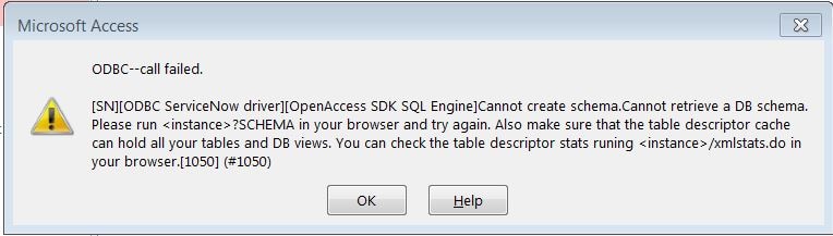

We recently had some users install the ODBC driver, but they get they got the message error below and a screenshot of is attached.
ERROR [HY000] [SN][ODBC ServiceNow driver][OpenAccess SDK SQL Engine]Cannot create schema.Cannot retrieve a DB schema. Please run <instance>?SCHEMA in your browser and try again. Also make sure that the table descriptor cache can hold all your tables and DB views. You can check the table descriptor stats runing <instance>/xmlstats.do in your browser.[1050]

OK, so these resolves were not necessary.  What was necessary in this case was that I had to create a local ODBC usernane and password.  As ODBC driver does not use SSO.  Once I created a local user account for ODBC and gave it the ODBC role which includes the soap_query and itil roles, then we were able to sign on successfully.  However, you all are correct that new properties can be created.
