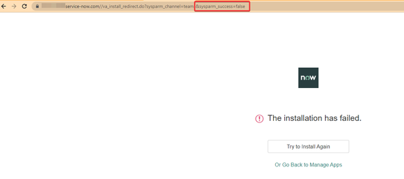

When I try to Integrate ServiceNow Virtual Agent with third-party messaging apps with MS Teams, it appears the following message and I don't know what I must do to resolve this issue:
Your tenant associated with email@email.com is currently registered with instance: https://devxxxservice-now.com
You are about to override it to this instance: https://devxxx.service-now.com

10-28-2022 12:17 AM
And I read this article as well:
https://support.servicenow.com/kb?id=kb_article_view&sysparm_article=KB0993612
where I can see I must get the error code to know more. But the error is general.
