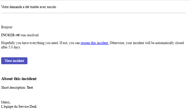

I’m trying to manually translate mail scripts in ServiceNow.

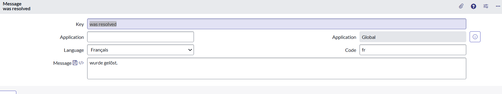

I’ve already tried using System UI → Message Keys and calling those keys inside my mail script, but it’s not working.
The translated text is not appearing in the email it still shows the default (English) version.
Has anyone done this manually before?
Please check the attached screenshot for reference.
Any suggestions or examples on how to properly reference message keys or static translated strings inside a mail script would be greatly appreciated.

Your code seems fine, I would assume that the code is running as system defaulting to english.
Just check that you have your last sentence using translation as well which is not the case at the moment before to your mailto tag
Try the approach explained here using
gs.getMessageLang('message_key', 'language_id');
