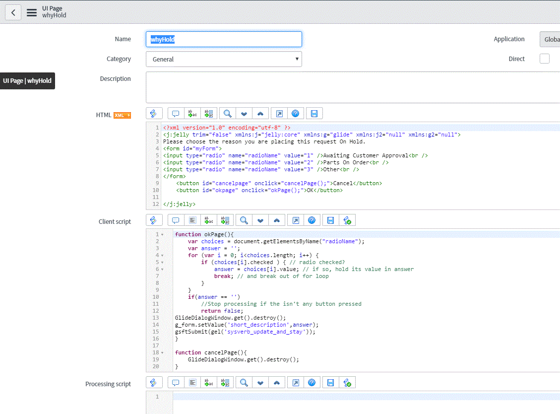

Then I have made a UI Page called "whyHold" which the UI Action calls on:
I put on 3 radio buttons and two normal(Cancel & OK). pressing cancel just destroys the popup,
Having OK checking which radio button is pressed. There is also a check so if the user doesn't choose a option,
they can't press OK.

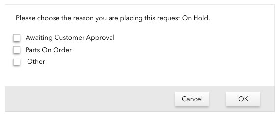

You have gotten my 90% of the way. This does work, however I'm trying to limit the # of buttons at the top of the form, especially since our technicians are using iPads to process requests so they have limited real estate. I was wanting to have a Place On Hold button that when clicked a dialog pops up asking "Why are you placing this request on hold?" and then below that there would be like 3-5 options for the tech to choose from. I have created a mockup of what I'm looking to do. There are several sub state reasons we are wanting to add to better categorize why something is on hold. I have access controls setup so that the technicians can not change the fields on the form, but rather follow a process via buttons at the top of the form that show according to the state of the request. This way we can automate several processes into one button without having the technician have to remember to go and update 3 different fields and then click save or update.
Please see an example below. When they choose one of the options and then press ok, it will change the state field on the form from Processing or Work In Progress to On Hold, change the sub state field to choice they selected and then saves the record.
