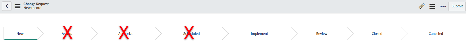

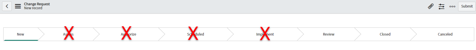

I am wanting to hide certain states on the process flow based on the Change Model.  For example, here in our company we have information changes, that does not require approvals.  I want to hide the Assess, Authorize, Scheduled, and Implementation states on the process flow.

I found the answer.  I ended up creating a UI Policy and making sure that the Isolate Script was set to false, then I added the following to the script and it worked.
$j("a:contains('Assess')").hide();
$j("a:contains('Authorize')").hide();
$j("a:contains('Scheduled')").hide();
$j("a:contains('Implement')").hide();
