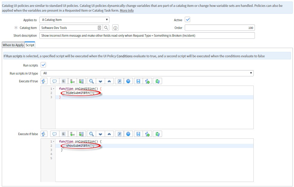

UI Policy:

      3. Declare below function in your custom widget (software development tool)
  and call this function from UI policy whenever you want to hide. Note : you can add another function for show.

Can you give alert in true and false condition to see which one is actually executing.
Hi Chirag,
I confirmed with an Alert message, at the beginning of the function, everything works as expected, but when I place the Alert after the hideSubmitBtn(); the message breaks (does not display).   So I assuming the function is crashing on the hideSubmitBtn();   Any ideas?
function onCondition() {
  //alert('Hide Button');
  hideSubmitBtn();
-Wesley
Hi Wesley,
Yes because looks like the function/weight is not loaded when you are calling the function.
Make sure that when your ui policy gets execute, the widget where the function is declared should be there in page before the function call.
Can you try with onChange Client Script? Or Can you call this function from your browser developer tool console ?
Hi Chirag,
Okay finally figured out what needed to occur/change with my setup. I updated widget code and then from a UI Policy called 'hideSubmitBtn()' and 'showSubmitBtn()' when the condition is true or false. Thanks with the direction. So now my issue is when the Submit button is hidden the bottom looks cut off.   Do you know of a way of adding or replacing a padding element (or other solution) when the angular.element is hidden?
function hideSubmitBtn() {
      angular.element('button[name="submit"]').hide();
Here is link that resolved the issue, but I am not able to get <div style="padding:1em 0"> solution to go where the button is being hidden.
Hide submit button for specific catalog item on portal

Hi Chirag,
Here is the link that resolved the issue, but I am not able to get <div style="padding:1em 0"> solution to go where the button is being hidden.
