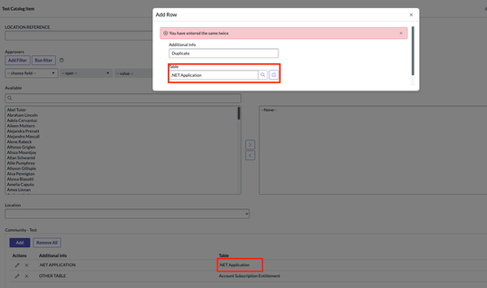

Results:
As you can see below screenshot, I was unable to add ".NET Application" twice. the Error message would be displayed when you click on Add.
Thanks & Best regards,
