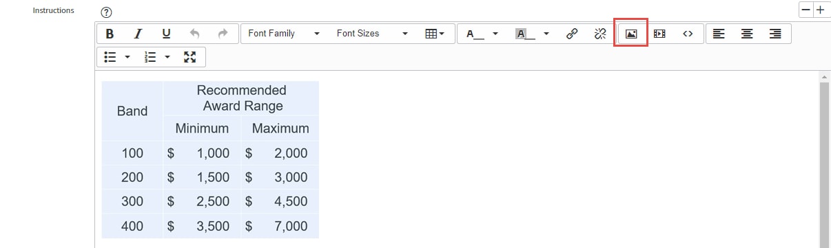

I got it working. Here is how I made it work. This works for Service Portal
a. Created the variable
b. Variable type = macro
c. Under the Annotation tab - in the Instructions box click the Image icon to add your image
d. Under the Type specifications tab - give it a macro of images_for_variable_items
