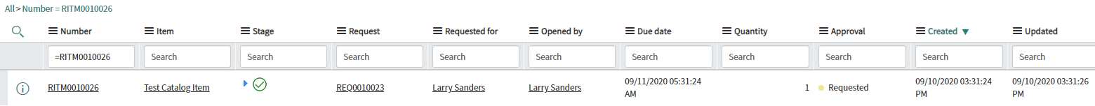

I believe it goes work, when the variables are updated. If you change a variable, the RITM is still updated when a variable is updated from within.
Updating a variable:find_real_file.png
Either way, you have a few methods, but the point is, you can run a BR on update of a particular RITM if those fields contain a value. The script will run to calculate and go from there.
