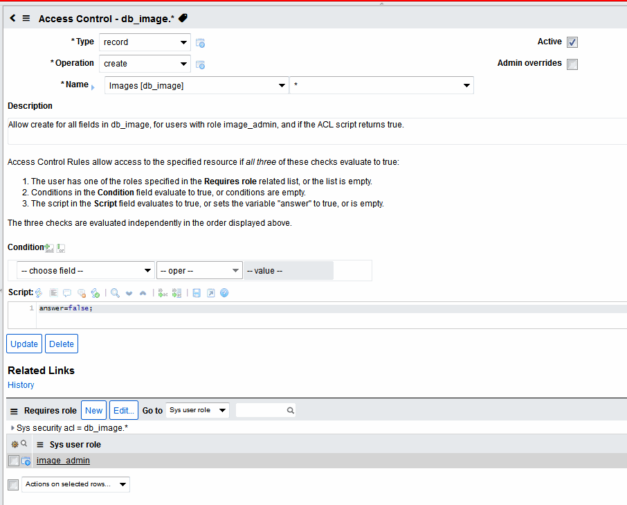

I even coded the script to always set answer to false.   See image below.
People can STILL upload images to db_image whether they have the role or not.

Jessica, I really like your solution, but it doesn't seem sufficient for me.
I created a create ACL and I added the image_admin role.
In an attempt to fully disallow new images, I even set the script to answer=false.
But the new button continues to appear and non-licensed people can still add images to the image library at db_images.
Here's the ACL:
Here's the popup with the "New" button (still!).
I turned on debugging of Security Rules, but the output doesn't even show the create rule when viewing an incident record.
I even display the list for "db_image.list" as an unlicensed user, and the ACL isn't mentioned in that list.
While no fields actually are displayed, there is a line per image and the "New" button appears on that list.
I'm not very knowledgeable about debugging the ACL's though I have searched it on the wiki.
Perhaps I can get some pointers?
EDIT:   Did I mention that I am on Eureka Patch 11?   Don't know if that is significant.   But I thought it worth mentioning.
You need to move the ACL to the table level - replace the * with none.
