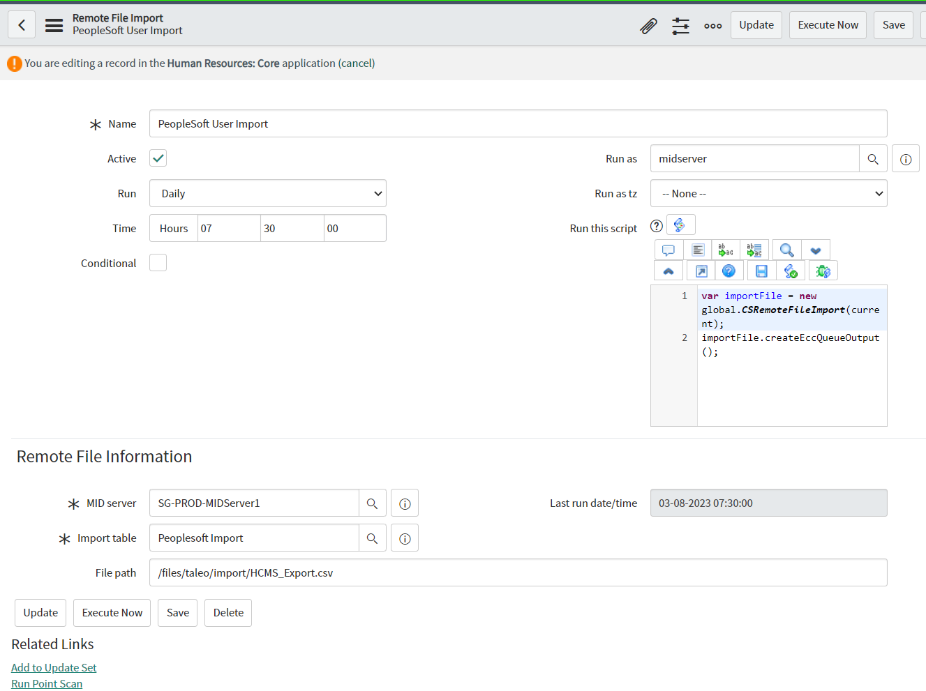

I have a similar/related issue. I am trying to address a problem caused by a Scheduled Job which is a remote file import to the sys_user table. This process runs daily to update the User population based on an export from our HR system.
For some reason this import is not updating the sys_user manager field correctly. This seems to occur when a manager terminates and is replaced by a new person. The job keeps restoring the prior (terminated) manager to the user record when it runs. If I fix correct the managers manually they get reverted back to the terminated manager the next time the job runs. I need to find this at the source as it is causing a lot of problems since workflow items are being assigned to these terminated managers. The remote file source table, which is an export from our PeopleSoft system, has the correct information. This scheduled job is causing the problem.
My problem is I have no idea how to find the actual script (if that is what is called) that this Scheduled Job is running. I need to see the details of what it is actually doing when it updates the manager field. I looked under Business Rules, Script Includes, Remote File Import. I found a transform map but it has no mapping for the manager field so there has to be another piece someplace.

How do I find the actual script that is running for this job? This script / scheduled job was built by our SN consultants. I have no documentation and no idea what the underlying items associated with it are called or where they are stored.
‎03-08-2023 08:44 AM - edited ‎03-08-2023 08:45 AM
I'd recommend creating your own post to increase visibility as this thread is from several years ago and already has a correct solution marked. To give you some assist, please check your script include for a record named: CSRemoteFileImport as shown in the screenshot you provided and the 'Run this script' field.
