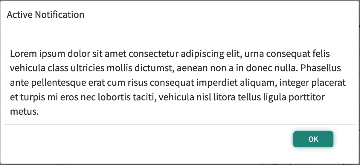

The end result is it displays the message fine, but note the line-breaks are not present in the UI Page:
What would be the best way to show the line-breaks, which are present on the string field on the form, in the UI Page too?

HTML will remove line breaks by default. If you want line break then you need to replace all line break with br tag.
Otherwise easy option is to include a pre tag. Pre tag will not omit line breaks
<j:set var="jvar_active_note" value="${sysparm_activeNotification}"/>
<p class="modal-title h4 modal-header"><pre>${jvar_active_note}</pre></p>

Hi Cris,
transfer the value to the <style> tag as next,
<tr>
<td style="white-space:pre-line">
${jvar_street}
</td>
</tr>
Please mark my answer as Correct & Helpful, if applicable.
Sandeep
‎09-15-2021 01:44 AM
Hi Sandeep,
Thanks for your reply; I have tried setting the inline style to the same 'white-space:pre-line', but this has no effect and the string does not preserve the line breaks
