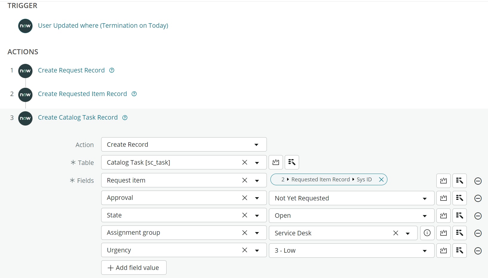

Hello experts, please I need your help, I am creating a flow so that when a user is terminated, it executes, I already created the REQ, RITM and SCTASK and triggers fine, but I need to fetch for the user's assigned assets and add the info to the sctask and RITM description, here is what I have so far:
I have the Trigger, and the 3 records created, I need to add the description and in there add the user assets assigned, could you guide me on how to do it?

I would recommend you setup a related list between the Asset table and the User table, then you'll have access to all the information about the Asset and links to the records instead of just a string of the names.
If you still want to add them to the Task then you'll need to do a look up records action and create a string variable.  The table will be your asset table and condition will be assigned to the trigger user (terminated user).  You would then use a for each loop to update the variable then use the variable to populate the Task when it's created.
Rick
P.S. You might want to change step 3 to the "Create Task" action instead of "Create Record"

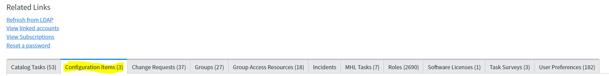

Thank you Rick, I already fixed the step 3, I have a question when you mention to setup a related list between the asset table and the user table, you mean to add it to the user form correct?
you mean this?
Jesus,
Yes that's it!  Now Agents will have all the CIs (assets) for the user one click away.

Question, I already added the look up records but in the description where I get the CI information I get the sys_id instead:
this is the flow step:
how can I modify it so that I get the name instead,
