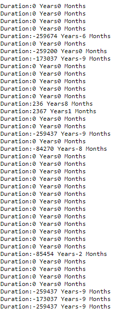

I'm getting in the below way:
Code:
var gr=new GlideRecord('u_contract');
gr.query();
while(gr.next()){
var duration = gs.dateDiff(gr.u_expiry_date.getGlideObject().getDisplayValue(),gr.u_effective_date.getGlideObject().getDisplayValue(), true);
var durationYears = Math.floor(duration/365);
var durationMonths = Math.floor((duration % 365)/30);
var durationDays = Math.floor((duration % 365)%30);
gs.log("Duration:"+durationYears + " "+'Years'+ " "+durationMonths+ " "+'Months');
O/P:-
