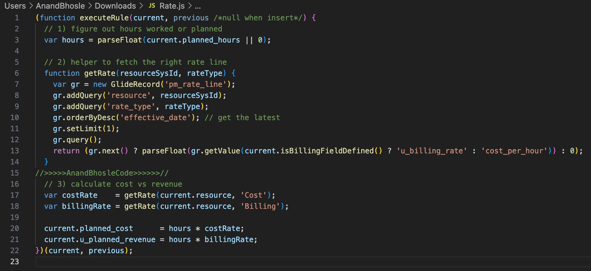

  • Extend the Rate Line table, field =Rate Type, Add New choice like Billing
  • Separate field is optional. If you’d rather keep cost and billing in two fields instead of re-using Cost per Hour, then on "pm_rate_line" table create Billing Rate decimal field type.
  • Add the field to Rate model form [From Project > Setup > Rate Models, open your Rate Model]
  • By default ServiceNow only looks at Cost per Hour for its “planned cost” logic. You’ll need a small customization to also calculate a “planned revenue” (or “billed cost”) field on your projects/tasks
  • On Project (pm_project) and Project Task (pm_project_task), add:
    • u_planned_revenue (Decimal)
    • u_revenue_to_date (Decimal)
  • Try Before Business rule on "pm_project_task" [Sample code attached in the screen shot]
  • Replace current.isBillingFieldDefined() with whatever check you need to pick u_billing_rate vs cost_per_hour.
    Hope this helps.
