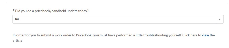

If a customer answers NO in a customer portal question, I need to show or link to a specific knowledge base document that the customers (store) needs to read/perform before creating a ticket.
How do I do this?
Any examples?
thanks
Tony

‎10-25-2017 10:45 PM
EDIT: Mihir's answer is much better. I was not aware that functionality existed
Create a UI Macro and place this in the xml, adjusting the text/hyperlink as necessary:
In order for you to submit a work order to PriceBook, you must have performed a little troubleshooting yourself. Click <a title="here" href="https://google.com" target="_blank" rel="nofollow">here</a> to view the article
</j:jelly>
Next, create a variable on your catalog item with the type of Macro. Then, on the catalog item's Type Specifications tab, select the macro you just created.
Finally, create yourself a Catalog UI Policy that will hide/display this macro field when necessary.
Your results should be similar to the following images:
There are a few other ways to accomplish this, but this is the cleanest in my opinion.
